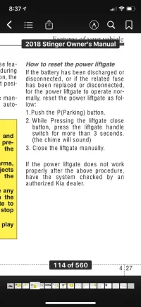

Thanks for the nhcowboy28, I have just tried that procedure several time, it does make the chime sound when I press the button and hold the tailgate switch. And I do close the tailgate manually afterwards and press the P button beforehand. But the problem still persists, will open but not close

SOLVED: Feel a bit silly but the solution was so simple. After some long searching and finding a post on the KIA forum, someone posted something on a KIA Sorento power tailgate and said they also struggled with the power tailgate and it was after leaving it open for a long time, probably something similar to a tinting. But the solution isnt to do the factory reset for tailgate by pressing any buttons or combination of buttons. But to just open the truck lid and then close it manually and that was it!! Because I had kept pushing the buttons, it would just confuse it, you supposed to not press ANY buttons and just close it manually and it sorts itself out. Apparently if the trunk lid is left open for a long time, it "forgets where it is" or in what state it is in, closing it manually just sorts it. Wasnt a complete waste of time cos in the search for the solution I figured out how to adjust the tailgate opening height as well which is handy cos I have had a few close calls with garage doors. The real BONUS is that I dont have to take it to KIA, what a hassle that would have been. Anyways thanks nhcowboy for the help. I got there eventually and learnt a bit more about my Stinger!!
