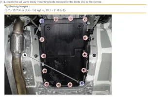

Neither torque specs for bolts nor order are present by KIA for Stinger. Personally I can't find such info nowhere :(

Oh they call the pan as valve body cover. Thanks mate. Will try a new gasket (OEM one) and 13,7-15,7 Nm.
