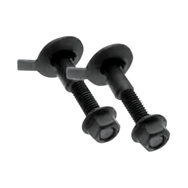

Do these Eibach bolts do anything the factory bolts can't? I'm not lowered, just Whiteline sways + Mando. The info blurb says lowering the car adds negative camber, so would lower the car actually help? Still trying to learn about tires, track vs. street alignment, etc.
Edit: never mind - looks like carid dropped the "stinger" part of the search when I clicked on these. They're only made for the Kia Rio..
