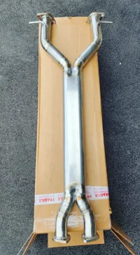

Selling my Tork Motorsports oval midpipe. It's been on the car for a little over two months. Purchased an EVC exhaust. Local preferred. Will meet up as well.
$550

This midpipe removes the stock two resonators which has nothing to do with smog, just sound. The 2-1-2 design is different than every other midpie that just removes the resonators. It gives it more of a custom sound while being a little louder than stock.
There is a lot of confusion to what the pieces are to a Stinger exhaust. Basically (aside from the turbos) there are 4 sections.
1.) Primary downpipes which have the primary catalytic converters bolted to the turbo and has the O2 sensors.
2.) The secondary which bolts to the primary just past the rear O2 sensor, in fact, you can see it with the secondaries removed. The stock one has a cat also, but no O2 sensors.
3.) the midpipe which bolts to the secondary up to the axle area.
4.) The axle back section which has the mufflers.
Most aftermarket cat-back exhausts have their own midpipe. You can get just aftermarket axle back too.
