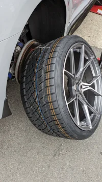

Not 20s, but 19x9 +32 (+35 with 3mm spacer) and 19x10.5 +45. 245/40 19 and 285/35 19. So tires a little taller.
Stock suspension.

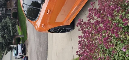

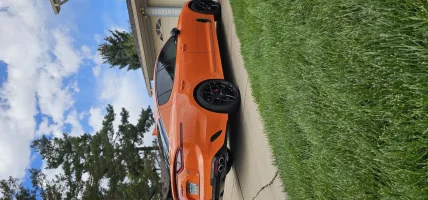

On a 22 GT line, No issues to report

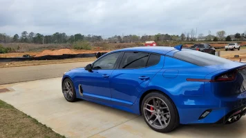

Looks incredible, this right ?
20x9 +35 245/35
20x10.5 +40 285/30
What have you notice with those wheels in comparison with the stock ones ?
20x9 +35 245/35
20x10.5 +40 285/30
20×9 +32 could go 35 if you want
20×10.5 +45 no rubbing 48 backspacing would have been perfect.
Stance Wheels SF07 custom backspacing and hub boar
At first it felt a little different trying to hold speed from the 18s now I don't even notice it drives great. No complaintsPXL_20230611_210130514.PORTRAIT.ORIGINAL~2.webp
I’ve heard about that spacer what is that for bro? Why some cars have it and others don’t
It fits the 19x9+35 without the spacer, but the wheel is very close to the strut. I think 20s have a little extra clearance because the strut angles in toward the center of the car. The 3mm is peace of mind for me.

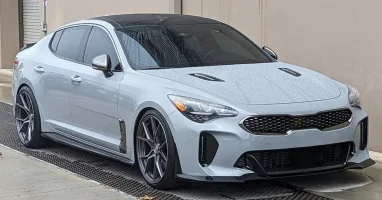

At first it felt a little different trying to hold speed from the 18s now I don't even notice it drives great. No complaintsView attachment 82668I will go
20x9 +35 245/35
20x10.5 +40 285/30 what do you think? I don’t know too much about this, first time I’ll do this so I don’t know what is a 48 backspacing, and i will go stance sf11, so the question is, do I need to buy something more than the wheels ? And how could I know ?

You would not want a spacer with that backspacing plus 40 you're 5 mm further out than I am the 45 backspacing.
Plus 35 front your right on.
