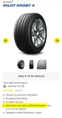

The rear tires on staggered setups get half the treadlife warranty; which on a PS4 is 30K miles, so, it looks like you are hitting exactly the 15K miles mark. I got about that many out of my OE PS4 rear tires too; my front tires lasted another c. 4K miles.

Wow, you're right. All this time, I thought that the PS4 also had a 30K miles treadlife warranty. It's only 20K miles! I got really exceptional service out of mine, then. Still sucks, only getting less than 15K miles out of a set of rear tires. This would explain why my PS4S rears are wearing better than the OE rear tires did. I was beginning to wonder. Hah.:rolleyes:
