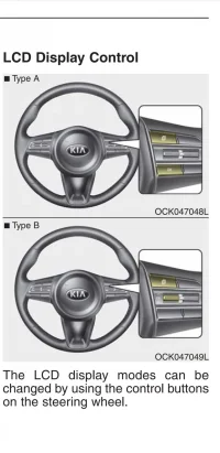

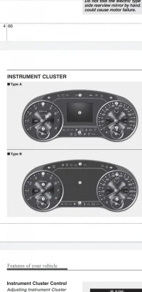

It's on your gauge cluster. Use buttons on the wheel to access.

Fine but what buttons in what sequence? Don
On my GT1 there are only five option screens; the psi screen is the fourth screen.
The ones on your steering wheel... There's a bunch of different screens in the gauge cluster that display various info.

on my gt1, when the center screen is showing the mph, i hit the down button (first one over towards the right from the center of the steering wheel. That will flipped the mph screen to tire pressure. if you hit that again it will go back to mph. if you press the first button over to the right from the center (lloks like 3 small lines) that will toggle thru mph screen, directional n,s,e,w, gauges and a couple more and then come back to mph again after about 5 different screens. all in the middle of the console between rpm/speedometer.
hope that helps.

Thanks much to ShannonC and baws22489.
Your explanations were fine, I got to the tire pressure screen on the first try. I think the manual should reflect the easy procedure you gave me.
