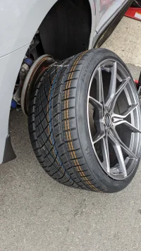

I ended up with a 293 30 in the rear. A bit of wheel gap, but I like it.
