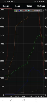

I've been experiencing this too. It's especially noticeable when I do something like hard throttle, come to complete stop then hard throttle again.
Let's say - I'm at a stop sign at a busy intersection with a high speed limit. Then the car in front of me goes, so I give it hard throttle (>70%) to quickly scoot up to the stop line, followed by brakes to complete stop (or near it) then WOT to pull out into traffic. And boy... it's like 3 seconds before the car really rips... I've literally shouted "GO GO GO" in my car before feeling like the car finally hit WOT.
My gut told me it was some BS transmission nanny protecting me from doing WOT/Brakes/WOT in short bursts or something. (My colleague described this behavior in his Audi and he hated it)
I tried from a stop to WOT really quick this morning, and did notice the "Throttle" seems to lag behind the "Pedal" by a fair amount. In this situation, I did feel a delay - but it didn't feel as long as in the "WOT/Stop/WOT" situation described above... I'm going to try and capture that in a log too...

turn off your traction control and try it again

Turn off your traction control and try it again
Most of that stuff comes from the trans module. But, there is always the pedal tuner if you want to try cranking up the gas pedal input gain.
