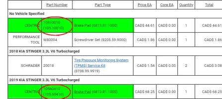

When the dealership did the brake job, they replaced them with what he said was a better version of what came with the car. He said that they had improved them from what came with the car.

hmmmm..... may be worth finding out what sort of 'better version' of pads they used
was it the same US oem? Euro spec eom? or aftermarket brand/type etc
worth finding out
given you said the vibes came back, i'm guessing he used the same US eom pads
Don't listen to him about getting fancy 2 piece rotors @ $1k to resolve this
not needed
just need a better brake pad.. and resurface rotor and make sure you bed new pads in properly

I'm not sure "better pads" does anything. As in a better pad material? It's typically the size/shape and weight of the pads causing the vibrations, or at least contributing to the overall frequency. If you can change the frequency, typically that will fix the problem, because the system will no longer have the same frequency and vibrations won't be able to propagate/increase.
Different pads on the other hand, the whole point about vibrations like this is getting something different in there. Rotors are the same way, get a different rotor on there and the problem would likely be gone, different frequency.
100% agree.
I suffered through 4 warranty brake disk replacements before the 60,000 km brake warranty was expired (Canada has good brake warranty).
On my 4th replacement of all 4 disks - I drove home and slapped in some cheapie aftermarket pads... that was at 60,000kms. Now I have 70,000kms and brakes are silky smooth.
The exact pads I am using now - if you are curious are -screenshot
My car is a 2018
I am using pads without the weights in the front (no noises)
Cost effective solution - I consider it - resolved.
More details and pics here --> Stinger Brake Pads Replacement
My car is a 2018
Prices in CAD. surely cheaper in USD
Good info identifying a combo that works.
