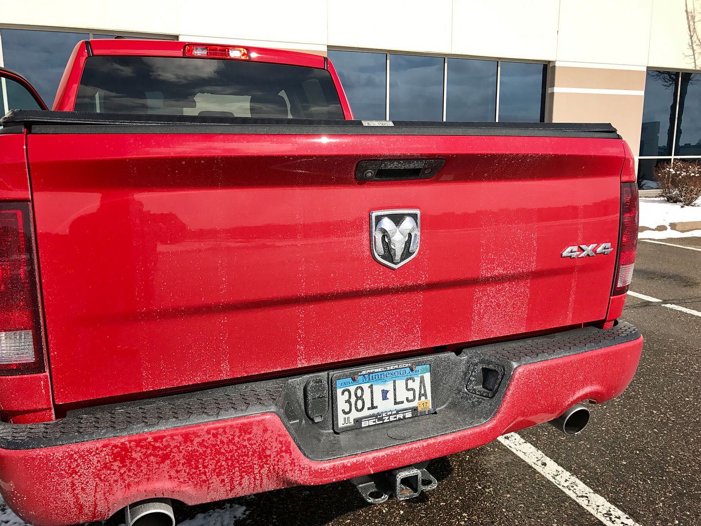

Here is my tailgate during the winter with 8 different coatings and one highly rated wax, which just happens to be the dirtiest section.
