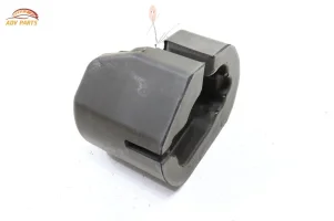

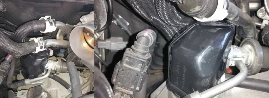

they are probably similar loudness between brands... but money lol... we get a slip on foam piece over the pump while lexus puts a solid 2 piece plastic piece that completely encloses the pump with insulation inside and that was after complaints and customers bringing cars back to the dealer that they updated the cover for the pump.
