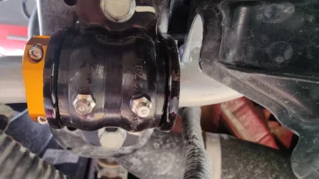

Had the Eibach sway bars on for four years this month, just started hearing some squeaks. On earlier threads i read it was important to have the right grease applied.
The Eibach bars come with zerk grease fittings on their bushings along with a stopper that is part of the bar in place of that goofy collar whiteline is using, it's a superior design against all other competitors.Speaking of anti-roll bar bushings... here's another modifying the modification.
While I was installing Whiteline anti-roll bars on the 2.5T, I opted for a set of greaseable bushing & bracket kit. Frankly, I wonder why any of the aftermarket anti-roll bar kits don't come with these in the first place. While it's easy to add grease fittings to any bracket (and that's what I did previously), these bushings have grooves molded into them that help flow & retain grease a whole lot better.
For the front 24mm, I went with Energy Suspension 9.5160G 15/16in. SWAY BAR BUSHING SET – Energy Suspension
For the rear 18mm, I chose 191161 | Greaseable Sway Bar Bushings - 18MM (0.70 inch)
I am not partial to one brand or the other. They are both quality. Those were just what were available on Amazon when I ordered.
The Zerk fittings are easy to add. The bushings with molded-in grooves are the important part to help flow and retain grease.The Eibach bars come with zerk grease fittings on their bushings along with a stopper that is part of the bar in place of that goofy collar whiteline is using, it's a superior design against all other competitors.
