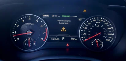

Does anyone know anything about the factory suspension on a 2018 Stinger GT2?
Multi link rear and Mcpherson front.
Adaptive dampers.
The only error I have seen reported on the dash is "Check electronic suspension"
I had this error VERY early on. - the ECS ECU was replaced in my case.
Further checking with a scan tool, there should be codes - but I have never had the pleasure of diagnosing any.
With a good scan tool, you are able to see lots of live data, such as amperage per damper (which I found interesting).

The problems I have are the rear is too soft and bouncy. I know because my last 2018 GT2 was much different than this one. And the rears on my last Stinger were starting to leak as well. This new to me car has 50,000 less miles and the factory rear struts are plugged in and are not leaking. Also, the firmness adjustment does nothing at all. I get no error messages in the dash, and my code reader(s) do not read any of the Stinger specific suspension information. I wonder what my next diagnostic move might be?
Has anyone heard of any such behavior with the factory suspension? I have heard that some have leaked while still under warranty, but that is all.
What sort of code readers is everyone using and what things (especially live data about the suspension) do they show?
Thinking of just replacing them with aftermarket, but maybe I am getting old and like the ride/performance compromise of the factory setup.
