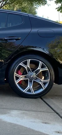

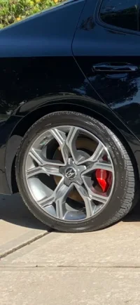

Super baffled. Rear passenger side 1/2" lower than rear driver's side from factory
Aug 11, 2020
84
51
Obviously this is driving me bonkers if I am posting on Christmas and am looking for help. The rear passenger side fender well (and something in the suspension) is a full 1/2" lower than the driver's side.
Cliff notes:
- Installed ARK lowering springs, correctly. Immediately noticed how much lower the passenger side was. Factory tire is tucked under the fender, way too low.
- Swapped the springs around thinking it may be a bad spring, same issue.
- Looked at pics with the factory springs in place when I bought the car a couple of years ago....lo and behold, the rear passenger side was 1/2" lower from the factory.
- All bushings/isolators/springs are correctly in place.
- Every bolt was torqued with the suspension loaded at ride-height.
- Driver's side rear and both front's are perfect.
- Pro Alignment has been done and is correct.
This will be an issue as I am installing new much wider wheels/tires in a few days.

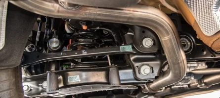

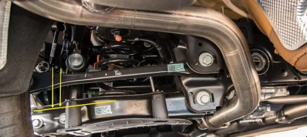

- Back in the day, one would rotate/clock the coil spring to raise/lower an uneven side, but the Stinger's lower isolators obviously don't call for that option, as there is a "seated position" built-in. Or you would slap in a coil spacer and call it a successful fix.
- I thought the lower isolator could have been rotated backwards from the factory, since the final clocking positions are opposite when comparing passenger/driver's, but the isolators can only be installed one way from the factory. To me, it looks if the passenger side spring could be rotated 180* safely, it would raise the side back up and be in the same position as the driver's side.
Thoughts, as I put my head into the spiked eggnog?
Visual stimulation:
Driver's factory settings:
Passenger's factory settings, sag:

Yes, it it admittedly tough to see with general pictures and the difference does show up in other examples that I have. As with a very small minority of members having the same issue and most not having it, I would guess it was a temporary factory error and there must be some sort of solution or something easy I am not seeing. Or....something non-factory that could safely fix it.
