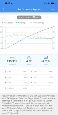

What works for me is to put it in launch mode and hold launch mode for a second or two and then let off the brake hard. Then hold the spin as long as you can without putting it in the ditch. Then stop immediately and do it again.
Then on the 3rd try leave traction and Stability control off but don’t engage launch control mode. Just use auto hold and mash the gas from a dig. It should hook up then and give you a decent launch even in the cold.
My best best time using this method was 4.37 0-60 mph. However, I am basically still stock. Just airscoop snorkels and a drop in panel filter. Everything else stock for a 2019 GT2.

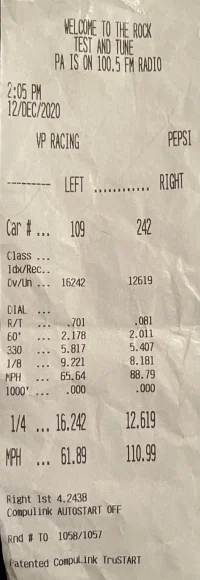

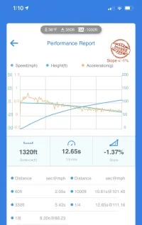

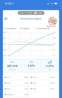

I was able to achieve a 4.27 0-60 mph with RWD and without Launch Control in Temperatures below 40 degrees Fahrenheit. Now this was slightly downhill so it was not valid to upload but it does show that fast 0-60 mph times can be achieved even with the stock tires on a RWD untuned car.
I also did a 1/4 mile run where I exceeded 111 mph without a tune. That is FAR faster than a truly stock RWD Stinger GT2 could ever do. The AirScoops snorkels really help there. That is basically the only modification I have done.
It is really impressive what this car is capable of with just $150 of modifications.
