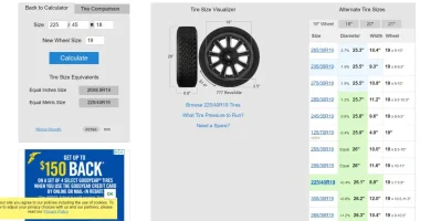

from the tire calc and posts, i'm understanding i can do this without purchasing new rims right? equivalent would be 225 40 19?
Not really, you'd be rotating wider rims front to rear, with a wide and a narrow rim on each end, and then wider rims in front and narrower in back. The 225 would have a more stretched sidewall on the 8.5" wide rims. If you pushed the car at all, I believe the handling would be wonky/unsafe. To run square, you need four wheels the same width. And if you're going to do that, then get the 18" wheels to gain that extra protection (and increased comfort as a bennie).

Size in my sig has worked well for the stock 18 x 8.0 wheels. I may go up to 245/45/18 next time around to get a slightly more sidewall cushion.
Stock was bridgestone re97as02 in 225/45/18. According to tirerack, that tire has a overall diameter of 25.9" and 803 revs per mile. The 245/40/18 PS AS4 is 25.9" and 804 revs per mile. So effectively the same. In a 45 series it's 26.7" and 780 revs/mile. Based on the garmin gps, the stock size (and current 245/40/18) show a speed of ~1-2 mph faster than actual (gps) at 60 mph. The larger diameter should take care of that and might even introduce a small error in the other direction (car going faster than indicated). We'll see what the time comes.
You will need at least one pair of wheels. Putting wider/offset wheels on the front is not a good idea, even if they have the same size tire as the other axle wheels. According to the owner's manual, your fronts should already be 18x8.0.
