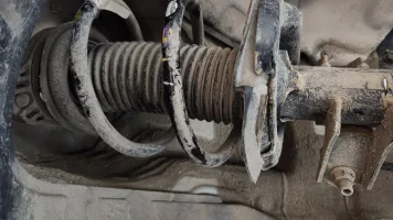

The shop that reinstalled my stock springs didn't get the rubber holder lined up all the way. Anyone think this is an issue? Can I easily get it back in place?

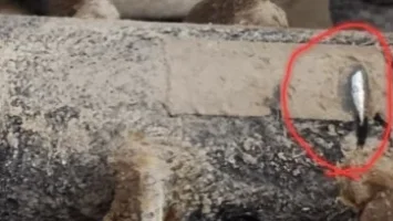

Sloppy job. I doubt you can align it without disassembling. Also not sure about your tire rubbing on the strut? What is that mark?20221219_193024.webp
if you can get some spring compressors to fit in there, you might be able to get enough room to wiggle it into place without disassembly.
Sloppy job. I doubt you can align it without disassembling. Also not sure about your tire rubbing on the strut? What is that mark?View attachment 76997
I wondered that as well. Not sure. My winter tires/wheels are on and this is year 4 with them. No marks on them that I can see. Very odd.
I'll try that tomorrow. Thanks.
