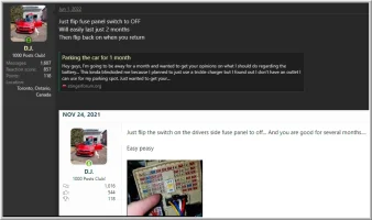

literally just 2 things.
  • fill the fuel tank to the tippity top
  • flip the switch to "OFF"
When you revive the vehicle
  • flip the switch to "on"
  • enjoy
This comes up yearly,
