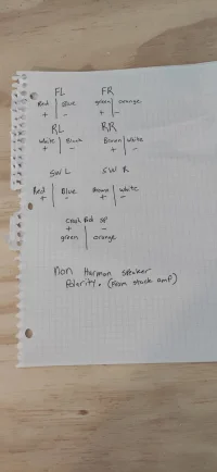

Think I'm in the right section.
If installing aftermarket speakers and using the stock wiring or doing a straight swap, here's the color to polarity for each door and the dash speaker.
