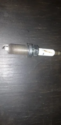

I've got a 2018 Stinger as well approximately 39000 miles I had the same type issue dealer ended up replacing a coil pack, I'm guessing they didn't check the plugs because I just recently changed them and one was cracked
Picture of the crack plug I pulled out, this was middle plug on driver side
The number 5 and 6 plugs cracked on mine the ceramic. So now they are going to replace the coils.

I have a 2019 with 82,000 so might catch you next year Gunner Like everyone else, I also had the spark plug issue at about 45,000 miles and the dealer replaced all coil packs and spark plugs with no issues since Overall a very solid and dependable car. My goal is 300,000 miles, so guess I will see if it makes it.
