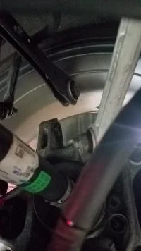

My last trip to the dealership was to have the limited-slip differential replaced under warranty. Since that time, aggressive downshifts now result in the car squatting under power and stepping out to the right in straight line acceleration. When the throttle is rapidly closed (after a full-throttle run), the chassis is also upset with a similar "squirming" coming from the rear-end of the car. The behavior is exaggerated during cornering maneuvers, obviously. Previously, the car was very stable and planted during straight line acceleration and I am trying to understand what has happened to change this. For those that understand RWD suspension setups, I would appreciate your feedback on these points/questions...
1) I assume that removal of the rear differential requires the removal of the entire rear axle. When these components were reassembled with the new differential, is there any adjustment, link, connection, etc. that could be responsible for this feeling if it were re-installed improperly?
2) My car is a 2018 model base GT that was built with a LSD as a factory option. As many remember, not all 2018 GTs got the limited-slip rear differential. With this in mind, it is possible that the dealership could have installed an open differential by mistake? Or possibly the wrong fluid in the new differential? Would an open differential perform the way described above compared with a LSD? What effect might improper fluid result in? Can I distinguish the LSD from the open differential by looking at the differential case?
3) The car is a little over a year old now (since first driven) and has roughly 15,000 miles on it. Is there anything else such as an improper alignment, blown shock, etc. that might account for this behavior?
