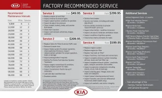

Everything said there applies to that 1 specific dealer.
Not all Canadian Kia dealers.
Service 1 or 2 or whatever dealer specific nomenclature they decided on , is strictly dealer specific.
You are definately NOT required to only use Kia branded oil filters in order to maintain your OEM warranty, confirmed with Kia Canada .
