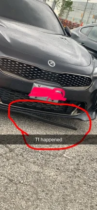

Hey guys,
Earlier in the year during a snow storm the front of my car got a little messed up causing my front lip near the bumper to get loosened up. I tried pushing it back in since its a clip on type of thing but it isn’t staying in there securely. At times it just hangs from one side and Its just super annoying. Just today it came out a lot and I really need some help on what I should do to fix this up. Should I 3M it and push it back in or screw it in? Has this happened to anyone before?

Having the same issue on mine since I picked it up 3 months ago. It keeps popping out from the driver side. I have to keep pushing it back in. The weird thing is that it 'clicks' in so not sure how it's popping out every other day even though I never scrapped it.
I zip tied mine in place. Not popping out now

Clean everything with isopropyl.
Use 3m vhb and some short self tapping screws.
Or find a front facia at a junk yard.
