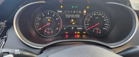

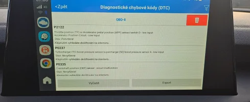

The first time was a few days ago. About 10 minutes after arriving home, it stopped starting - the starter turns for a long time, but the engine does not start. The frontal impact assistant malfunction lighted up on the instrument panel display. In my cheap diagnostics, it says a throttle sensor malfunction. So I pulled out and reinserted the throttle body connector and the engine started immediately and drove without any warning light. The next day, the situation repeated itself exactly the same. Everything was fine all day. On Friday morning, about 2 kilometers after starting, the engine died while driving. I stopped, again the frontal impact assistant malfunction on the instrument panel, but the EPB, AUTO HOLD, engine and oil lights came on. About the tenth time, the engine started, the car was in limp mode, the tachometer did not work, the engine was jerky, the engine light was on and all the others that I mentioned. My diagnostics showed the TP throttle valve, the APP accelerator pedal position sensor and the CKP crankshaft speed sensor. So I had the tow truck take me to the service center /car still under warranty, 84000km, no modifications/. There they connected it to the KDS and it showed NOTHING, the car was running perfectly fine, no warning lights. They are keeping it there, they will find out what is going on...

Thank you very much for the answer. Yes, my scanner also showed two errors, the first failure was the gas pedal or throttle. I also showed it to the service. But they didn't listen to me at all...it didn't show them anything on their KDS diagnostics / I don't understand / so they didn't pay any attention to what I told them, nor did they try to use common sense...
Your scanner may have cleared the codes, or they may have been temporary or pending codes. Those can get erased once the issue goes away.
