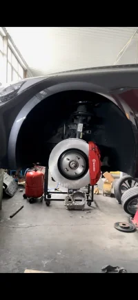

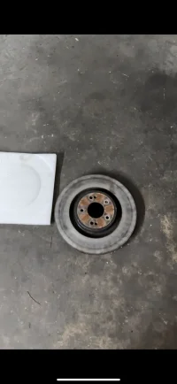

Hi i have kia stringer 3.3 t 2020 my car shakes when i brake at high speed . Mechanic told me that i need to change front left rotor and pad but i already did it (with oem part's)twice and didnt drive it even 6000 miles. Can you guys help me to find solution on that?
Thanks.

I belive you always need to change both sides, left and right. Also a lot of people are having a vibration brake problem with oem pads. Going with aftermarket pads seems to be solving the problem.

I changed both sides with oem parts,But I'm still facing this problem, even the experts at the service can't find the reason.(

If you're using OEM pads, and the vibration comes back after a period of time, it's due to pad deposits being unevenly left on the rotors making it feel like the rotors are warped. It's a very common problem on the stinger. Most people have solved it by using aftermarket pads. There's numerous threads here on the issue.

Your pics are low resolution, so can't really tell what's going on, but that middle pic looks like the rotor has heat-spotted. You can almost see the "ribs" showing through the rotor wearing surface. That happens because when the rotor get really hot, the areas that are tied to the vent ribs underneath get hotter. This is because those areas do not benefit from the axial cooling air flow cannot cool as well as the areas between the vent ribs. Once your rotors have heat-spotted to a severe enough degree, their structural integrity is compromised and you'll start experiencing problems, including vibration.
Not clear on the exact history of how you run your brakes and when you did what, so cannot tell what exactly happened. It is possible that uneven brake pad material deposits caused the hot-spotting. Again, it's impossible for any of us to tell from a few grainy pics. A lot can happen in 6000 miles.

I agree that there is not enough information to really figure out what is going on. By “bent”, we are assuming that the rotor is warped. Has the rotor runout been checked with a dial indicator? If that middle picture is the current rotor, it looks like it has been severely heat soaked and I agree with has already been said that it is no longer serviceable. It needs to be replaced. What we do not know is how it got so hot. This could happen if the pads are not moving back when the brakes are released and they are stuck against the rotor.

no
it is more likely that the OEM pads have left pad deposits on the rotors, causing brake pulsations.
