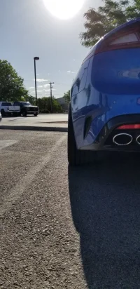

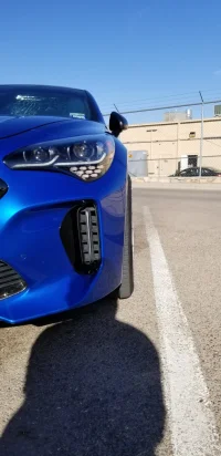

I got Squared set up 19X8.5 +30 all around with 255/35 tires and on Eibach Springs. Mine is Flushed look!

RWD here! Front stock wheel width is 19X8 and Rear stock width is 19X8.5. So i just squared it uo to match the rear width to 19X8.5 all around and it looks better or nicer. I don't think it will stress the front drivetrain for going half inch more in the front.

View attachment 24281 View attachment 24282
Looks really good. I like it, bit I am inclined to say that there is something different about the AWD. Every 8.5 +30 on front of AWD I have seen has alot more poke than you. Confused

Can you show an angle pic?
Do you have an example? 8.5+30 is currently the flush standard. Check the offets thread for examples.
