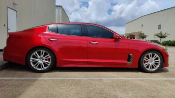

For daily commute, I drive the Stinger with 235/45R18 on a set of 18x7.5 Genesis OEM wheels from my old '09 Genesis sedan.

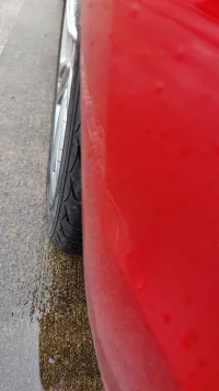

You might think it strange to run rims that are narrower than the stock 18x8. The reason is more than the fact I just so happened I have them. The 18x7.5 wrapped with 235/45R18 is far better protected than the stock 18x8 with 225/45R18. Take a look at your own wheel/tire and compare to the pic below. If and when my wheel takes a pothole hit, the deformed tire will tend to wrap around the wheel rim, thereby cushioning and protecting it, rendering the rim much less likely to be bend. The added bonus is these old Genesis wheels are surprisingly lightweight, at around 23 lbs. The stock 18x8 weighs in at 30 lbs. All else being equal, lighter is always better.
No, this setup will not corner like a Formula race car, but for street wheel/tires that will encounter all manners of public roads, I much prefer this compromise. Handle well enough for spirited driving and the ride quality is like magic carpet... almost as good as my old Kimchi Mercedes. :)
