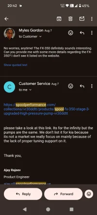

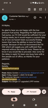

Basically I've been having fuel pressure issues with my car on 93 pump gas for a while ever since I added my primary downpipes. I'll also add that I don't have CPI or WMI. I've tried out the BMS stage 1 HPFP which helped some and the Spool Performance LPFP which helped even more. I'm pretty sure everyone knows about the Spool Performance FX-180 and FX-200 HPFPs, those pumps don't work because they require custom tunes (which don't exist). I asked Spool's customer service and product engineer if there were any alternatives to the FX-180/200. He told me that the FX-350 for the VR30DDTT platform (their upper end HPFP) would work on the Stinger GT and wouldn't require a custom tune.
