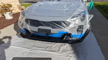

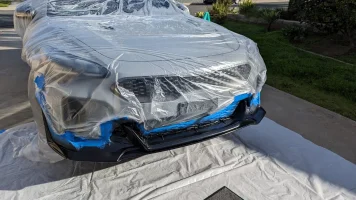

So my M&S spoiler paint didn't last long at all. Clear coat was peeling. Paint was faded rock chip from the freeway. It was bad. A little over a year. Not feeling good about the manufacturing process. I think they cut corners so I'm redoing it myself. Quite the pain but pleaseed with the way it's coming out so far what you see now is the second coat of paint. Still need a wet sand clear coat.
Semi gloss black semi-gloss clear coat
PXL_20240115_173352748.jpgPXL_20240115_173348282.jpg sand clear coat polish wax?
What are you using for clear?
Might have been easier to remove the bumper cover from the car. Comes off fairly easily. Would make it easier to wet sand, etc.
It has been many years since I last shot auto paint. It's a labor of love, but I've always find it very rewarding.
That would have been the proper way to do it and at the same time I wanted to install the snorkels for air intake but this is my daily driver so doing it the hard way
