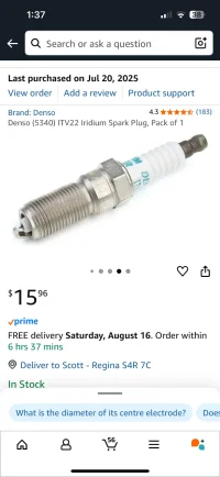

I had a mechanic say that the plugs in the picture weren't able to be put into the stinger because it doesn't have washers on it like the densos I already have in the car. Can anyone comment on if these spark plugs are an ok fit for a tuned stinger? Or should I have just reordered from BMS instead of Amazon?

That's the wrong plug, at least for the 3.3 v6.
Spark plugs have two basic styles - a washer seal or a taper seal. You can't swap that. The picture shows a taper seal.
The Denso series for the v6 is IKH - 5345 for stock heat, 5346 for 1 step colder.
