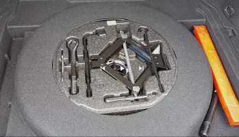

Hi Guys, Hope I'm in the correct section. I purchased a GTS in the UK in January, (best buy EVER)
Trouble is, in the UK, it doesn't come with a spare, and I'm having trouble obtaining one. The dealer can get all the kit except the tire, and they unsure of the tire size. I have been told by another spares department, the size should be 135/80/R18. Could anyone confirm this for me. Would really appreciate your help.
DC4F8146-E4AD-44F3-995E-02DF81DB1D08.webp 16024542-10C7-4601-A037-870BEBBDA711.webp
I had the same problem - the Dimension is correct - some parts i got in Germany - Cover and Wheel i bought in Belgium - all together about € 700.- :devil: :cry: :mad:
Thanks so much for your help......Doesn't seem to be much support in the uk. Really appreciate your assistance.:):laugh:
