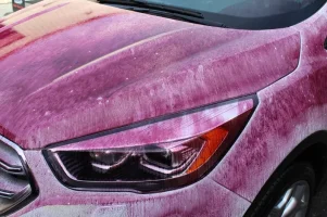

Yeah, I don’t see it on my wife’s silver car, but the remover sure does turn deep purple when I use it on her car. I haven’t noticed the Griots garage version do anything to any of my trim yet.
