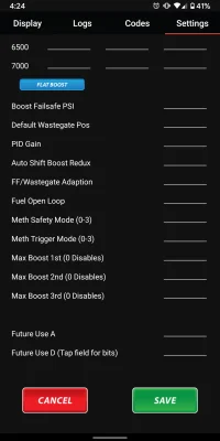

Have you tried adjusting the boost by gear settings?
no, how do i do that
Does this affect map 8 or only map 6?
Both your target boost on that log and actual boost is not very high in gear 1 and 2. I hit those boost values on map 2 in first and second. Without higher boost in first and second (like 17+ PSI), plus traction, I don't think you'll be getting much faster.
