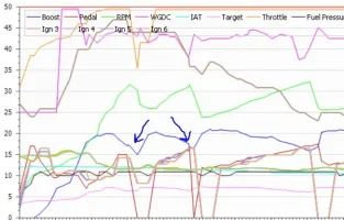

If you have a JB, you can clearly see boost drop significantly after 5k. The goal is to keep that boost flat between 5.5k and 5.8K. I've attached a perfect example of an automatic shift and what happens to the boost. Also, notice the orange line drop hard at the 1-2 shift, that is the throttle closing. This was an aggressive Map7 and shows what we are stuck with when it comes to pushing the limits. If this run was done manual shifting, the RPM line would not go above 6k, the boost wouldn't drop as much, and that throttle wouldn't of closed. It probably cost a 1/10 or maybe 2/10th.

On map2 I get throttle close 1-2 and sometimes 2-3. If I paddle shift 1-2 would I need to 2-3 shift? or is there a way after 1-2 shift for the trans to take over again. Or if not at what rpm should I hit the paddle for best upshift?

Sold the car. But the answer was partially cold weather related and secondly short shifting is recommended. There are recommendations for where to shift each gear on the n54 forums
short shift! if under full throttle shift at 5.8-5.9k so the shift is actually completed around 6k. Boost tapers above that. If you were to short shift say 1-2 and 2-3, and you are in sport mode, you would need to hold the right paddle down to go back in to auto mode, or do it manually however a GT1 or GT requires.
