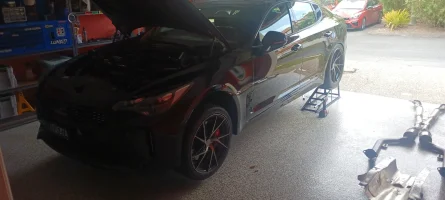

I'm having some electrical issues. I currently have a 2020 Kia Stinger GT1, 67k miles. We thought it was battery issues. So I had to remove everything from trunk to get new battery replaced. The battery was replaced and isolator was installed to help with drainage. Got the car back.. Took it for a drive and it showed no issues over the weekend. Now driving to work, the panels on the dash started to flicker on/off. I arrived to work and not the battery is completely dead. We were able to jump start it, drove it like three blocks. Now battery is completely dead again. Any suggestions??? I pray its not the alternator .....
