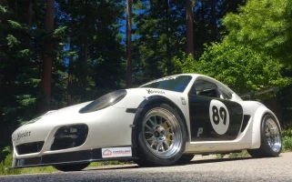

7711905C-FC22-4072-9C47-F8CD23FD6BB2.webp Looking at AX results with Stinger. Was faster than bmw 335 i, Mazda Rx8, lots of Porsche’s. And about second off BMW M4, MUstang 350 GT , bunch more Porsche’s. Finished about mid pack out of 60 cars. 6 seconds off mod class car that set TTOD. Lots to figure out to make Stinger be competitive but it’s a hoot to drive. Probably my last AX in Stinger. .....Going back to my dedicated Turbo Porsche Cayman ax car in pic above.
