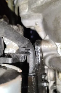

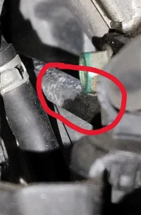

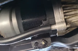

Hey everyone, looking for some eyes on this.
I have a 2022 Stinger GT i bought 2 months ago with 65K on the clock, and I recently had Kia Corporate check my VIN and they confirmed that the SC300 (Turbo Oil Feed Pipe) recall was marked as "Completed" in May 2024. I had seen the leak there, but they said it was done. So i put up the car again to check to see if the line was actually replaced.
I have noticed some oil loss outside the usual 1 quart per 4K miles or so...(about 3/4 quart extra loss in a few weeks). Here is what I found:
  1. The LH Turbo line is not a braided or reinforced line, it looks like standard black rubber.
  2. There is active seepage right at the bracket/crimp connection near the turbo.
  3. The bolts have green paint markings on them, but the hose itself looks original and is definitely failing
So i have to ask those in the know-
  • For those who had SC300 done, what does the official Kia replacement hose actually look like? Is it supposed to be a different material than the passenger side?
  • Has anyone else dealt with a dealer "marking" the bolts with paint but not actually swapping the pipe?
  • Since the recall is marked "Closed" in the system, how do I get a second dealer to redo it properly under the safety mandate?
I’m supposed to drive this car 2 hours to Massachusetts this week. I’ve topped off the oil, but I’m pissed that a "completed" safety recall is currently leaking. To me, it doesnt look like it was even done but i could be wrong. But if Kia just ignored the repair and marked it done anyway i wont stop until they fix it..Thanks everyone!!!

This is very weird. I've never heard of the oil feed line to the LH turbo, or RH either, being "rubber" at any point. The temperature would make this impossible? What do I know? Now I am just confused by your post.
edit to add, the "inner tube" is rubber, but the outer layer is braided stainless steel. Where is your braided stainless steel in any of your pics? Are you showing the actual feed pipe or something else?

The SC300 recall does not use an exposed stainless braided line like aftermarket turbo feeds. The OEM LH turbo oil feed assembly uses a rubber inner hose with a heat-resistant outer sleeve and crimped fittings.
The recall replaces the hose/pipe assembly at the turbo side bracket which is exactly where the seepage is visible in my photos. This recall addresses seepage, not only active spraying, and many documented failures begin this way.

I'm also not clear on what I'm looking at, do you have some zoomed out pictures? The third one does not look like the turbo, it looks like the wastegate actuator, except that the finned portion would be black instead of silver, and there's no rubber line on the WG actuators.
Fair question it was tight area and bad angles make it confusing. I only have ramps right now and it was hard to get under the car. The photos are taken from underneath, looking up at the LH turbo oil feed line and bracket, not the wastegate actuator. The wastegate actuator is a sealed mechanical unit and does not have rubber oil lines or oil seepage from what i have researched. The seepage shown is occurring at the oil feed hose crimp/bracket area, which is the failure point addressed by the SC300 recall. I verified the surrounding components (WG actuator, turbo housing, oil filter housing, adjacent hard lines) and they are dry. I can grab wider reference photos if needed, but this is the oil feed assembly, not the actuator. However i am new to the Stinger and dumped a 2002 Acura TL Type S for this car so a 20 year jump in tech has been a real eye opener. I used a high powered flashlight and looked at everything i could see with the underpanels off to make sure the leak wasnt coming from somewhere else and traveling.
