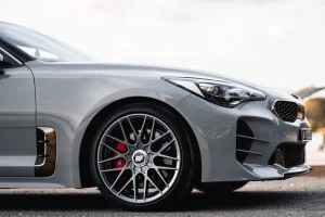

Hey Stinger fam! Sorry if this has been asked before but I've had no luck finding any threads regarding this.
I'm looking at upgrading my wheels to this staggered 19" Rotiform RSE setup;
- Fronts: 19x8.5 5/114.3 P35
- Rears: 19x10 5/114.3 P40
I've seen people running similar specs on different wheels but I'm yet to find anything with the RSEs. Does anyone know if they'll fit over the big Brembo brakes without any issues?
Any input is appreciated, thanks heaps :)
Edit: Just received a response from the manufacturer stating that the wheels should work just fine with the Brembos! Thanks for your help guys :)
Any 19" wheel will almost certainly fit. You'd need the dimensions of the inner profile from the wheel manufacturer to really check, though. Get that, take off a wheel, and spend some time with a tape measure and/or cardboard.
The only time I'd be worried about a 19" is if it was a soft lip wheel.
Heck, nearly any 18" standard wheel fits just fine.

Cheers! I've just received a response from the manufacturer that the wheels should clear the Brembo brakes just fine!
