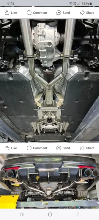

Anyone installed a Rhino cat back exhaust on their Stinger. Sound clip sounds pretty good, just want to know if it drones
If it's 2.5" it's gonna drone ... anything larger than factory std is going to drone.
Otherwise sorry cannot help you personally.
Thanks. It is 2.5inch but does still maintain a centre muffler rather than straight through pipe unlike most. I wondering if that would make a difference and reduce/eliminate droning??
The only way to guarantee no drone is to replace the fake tips with real ones that carry the sound all the way out.
I replaced my factory middle resonators with the TORK product which is just a straight thru box twin 2.5" in and out but with factory bimodal mufflers at the back they are 2" dia each and there is no drone with cats in place...
Pics of TORK system but I have factory pipes now before and after...
Looks good. So yours is a factory bi-modal exhaust but with the Tork centre section only…everything else is stock? Stock downpipes?
Mine is 2020 so I don’t have bi modal factory exhaust, just the standard factory exhaust. Just looking for a better sound with no drone
It sounds awesome...
