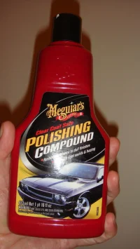

I've been impressed at how effective Meguiar's hand rubbing polishing compound is. I have a buffing wheel compound too, but have only used it (by hand, by the way) a couple of times, before finishing up with the burgundy bottle stuff: i.e. the heavier buffing compound has not been needed. So, I think that using an equivalent hand polishing product should handle this. And when I am done getting out the light scratches or abrasion, I put on two or three layers of wax over that area. So far, this remedy creates a finish that is indistinguishable from the surrounding clear coat.
They are not the same. And I have used both. The ultimate clear safe rubbing compound is better (less risk of damage). Follow with Polish if you like. Then sealant/wax.
