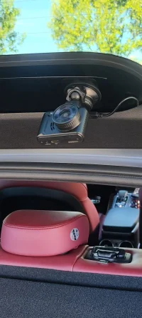

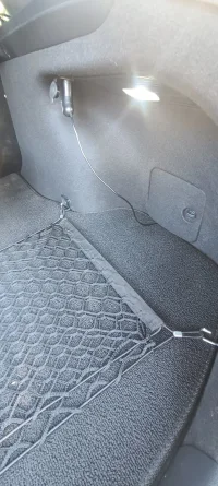

Can anyone tell me which of the fuses is switched, so that it only comes on with the ignition? I have checked with a multi-meter, but I cannot seem to find a switched fuse. I was trying to wire in a blackvue power magic pro, but when I wired it all together, the power did not come on to the rear view camera. I had already installed a lighter socket back there, and it works great, but I keep forgetting to unplug the camera, and do not want my battery to go dead.

Well, switched the fuse tap around, left the cam plugged in for an hour, but it still powered the camera. Oh well, guess I will try to remember to unplug it after every drive, and carry a portable charger with me.
The camera is just plugged in by a lighter. But I am trying to install the power magic pro, which is a timer, i think made by Blackvue. But it is 3 wires, constant power, switched power, and ground.
