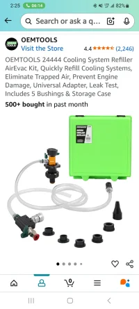

Yeah it was a pain but I used this vacuum and at first it seemed to not get hot at idle so I ran the engine revs up and it appears to be better. But I'm going to take it for a drive to check it again. The fan comes on and the temp gauge is normal so that's a plus.

The general idea of the above is to put a vacuum on the entire system, then use that vacuum to fill. Did you run out of vacuum where it didn't end up getting full?
The system did get full using this and the gauge went to zero

I bought open of the funnels that sits on top of the radiator port and you just run the engine and squeeze the hoses and the filled funnel just lets the air out and liquid in.
Is there a difference between these? One better over the other?
I'm not sure what the difference is
Assuming no leaks, vacuum filing usually works best to ensure no air is present in the system. That's how they're filled at the factory. Imagine wasting time to burp a million cars...
