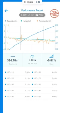

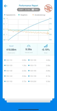

Hi people of the forum, opened this thread which has a log as the title says the type of BEF. Please tell me about the log you see it and does it look fine? Wmi ratio 80/20 and right about e30 mixed with 93 pump gas.
If it is a fine log then testing a draggy in the 60mph -130mph / 100kmh-200kmh average range of 9.56s is in line with others. Please share a draggy time with the BEF so I can get a look of what you fellow members have in common.
9.5s 100-200 is fairly slow but the low boost you are running justified why is it doing this.
Your trims are fairly high conserding you are only running a 19-16 psi boost curve for each gear so I assume your WMI nozzle is small.
So here is how you improve the power output. You should switch to 17 deg bef and run higher boost.
The reason for suggesting you to switch to 17deg is you are pulling timing already with this low amount of boost. It's nothing drastic but I can see the higher timing is stopping you to run more boost at this point hence you are leaving the power on the table. Since your trims are already higher than 25 with wmi and boost this low, I would assume your trim will settles even higher with more boost. At that point you will have room to run a even bigger meth nozzle .
You've got some timing corrections so do a test purge and confirm the WMI nozzle has a clean misting spray pattern. And up the E85 mix up to E50, raise WMI additive to 70, and relog!
For 60-130 runs start in 3rd gear around 40mph and don't press kick down.

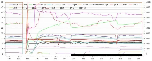

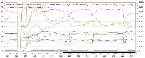

Need 2-6 days time frame to follow the above steps. I have both 17 and 19. Meth will be set to 70. Nozzle will be looked at or in my opinion look for a new one. If I’ve missed something I’m just writing to say thanks for the support.
no ethanol mix. Will have a 40% ethanol mix and post a draggy soon and ignore going to dyno again.
Hi I’ve raised a little of the octane level. Never bothered trying again.
Seems OK, corrections are pretty small and not increasing.
