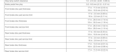

If the 8mm measurement is accurate..
And the pad thickness is 10.6mm new (front)
And the service limit is 2.8mm (front)
You have used only 33% it your pads for 50,000kms of driving - which means if you continue to drive as you do, you should reach approx 150,000kms before your pads reach the service limit of 2.8mm thickness.
