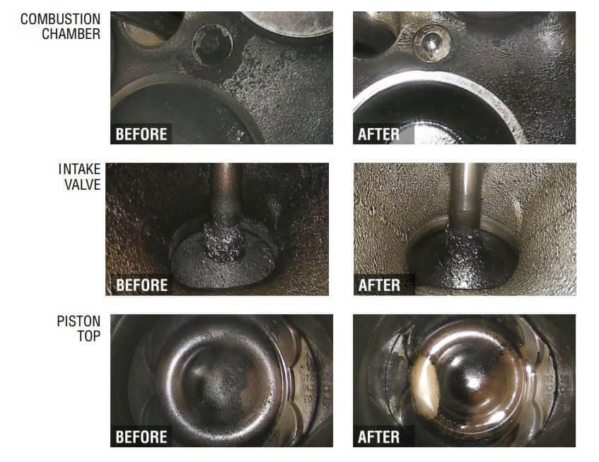

fuel cleaner wont do anything in our engines. the intake vales (not the face thats in the combustion chamber) but the rear stem that sees the oil mist is pre-fuel. so it wont get washed with the cleaner. oil changes is important for sure. extended changes increases the acidity and breaks down the detergent package that leads to excess vapors.
the build up on the valves leads to the valve not being able to close fully and seal leading to compression losses. among that, air flow efficiency drops alot.
example pic

You clearly have not inspected a direct injection engine after a few years or a few tens of thousands of miles. The buildup on the intake valves is truly something to behold.

I've seen the pictures. That's really all they are: pictures.
