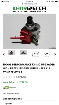

Hey guys just curious has anyone picked up a high pressure fuel pump? Khartunerz has one by spool performance. I know the stock fuel pump become an issue at a point the higher HP you go. Just curious this is the first time I have seen these on sale.E1547756-72A6-4627-9E71-91324BE18E03.webp
