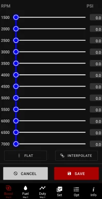

Boost Menu
All RPM ranges set to 36.0

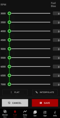

Fuel Bias Menu
all RPM ranges set to 8

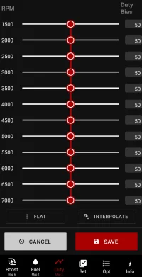

Duty Bias Menu
all RPM ranges set to 7

Boost Menu
Fuel Bias Menu
Duty Bias Menu

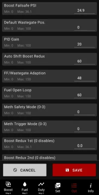

Opt
- Boost Failsafe PSI: 36.0
- Default Wastegate Pos.: 0
- PID Gain: 30
- Auto Shift Boost Redux: 90
- FF/Wastegate Adaption: 60
- Fuel Open Loop: 0
- Meth Safety Mode (0-3): 0
- Meth Trigger Mode (0-3): 0

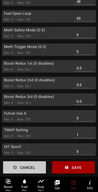

- Boost Redux 1st (0 disables): 0.0
- Boost Redux 2nd (0 disables): 0.0
- Boost Redux 3rd (0 disables): 0.0
- Future Use A: 0
- TMAP Setting: 1
- IAT Spoof: 0
