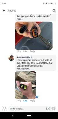

I'm running into an issue with a protuner that I bought and was wondering if anyone who's installed cam help.
My crank sensor plugs don't seem to be right. It is labeled as Cam and definitely won't connect to my crank sensor.
Can anyone provide any feedback?
I've reached out to Lap3 but it's a weekend.
Thanks!

You sure you got the right connector on the car ?
There are only two in that region and, based on their images, I do.
I would make sure just to be safe.
I remember when I helped someone install their we ended removing the driver side secondary down pipe/ mid pipe to get to the cam connector.
Seems odd that lap 3 would put the wrong connector unless that is for like the Korean market or something.
You will probably have to wait until the Tuesday and reach out to him.
Gotcha. I had the downpipe off but maybe I'll see if a local shop can throw it on a lift and finish it up. Thanks!
Here is what the normal harness looks like.
So, messaged Lap3 and found that the g70 harness is different than the stinger one. Essentially the 3.3 doesn't have idle stop and go on the g70 so I'll need a new harness and have to get the tuner remapped. Not a huge deal, but I wish I knew that ahead of time.
