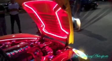

Make the box out of clear plexiglass or something. Best of both worlds. You can see the "awesomeness" and still get the benefit of the box keeping the hot air out.

Has that been done before? I've never been one to care about dressing up under the hood. I was all about function. I had a car built one time and the builder was telling me all about spraying the manifold covers. I was just like, "yeah, no". Some kind of red or something. I just want the car to be fast and I never intend on opening my hood unless there's something wrong. :p

I have never seen it, but I imagine it has. All those cars with the neon and clear tubes and God knows what else they do under the hood.

I will discuss plexiglass as a possible option with my builder. Sorry but the neon will be out of the question. That is not our style t all lol.
